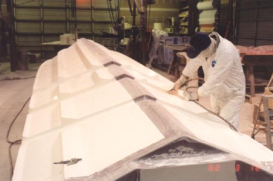

This???

On my pleasure boat the deadrise is not constant, but is an average of 24 degrees, being more than that from the centerline of the pad (bottom of boat) and decreasing from the first strake out to the waterline.
On our Unlimited Hydroplane, we have dyhedral in the starboard sponson bottom and anhedral on the port sponson bottom. Essentially we're "banking" the boat thru the turn, while the lateral centerline is almost level thru a turn. Depending on the race course, we adjust both dihedral and anhedral, the tighter the turns the more of both and the wider the turns just the opposite.
We have aluminum I beams on the sponsons with quick change receivers for different shims. The angles run from 4 degrees to almost 0 (laterally). The angle of attack is also adjustable (running angle from sponson bow to sponson transom.
If you can make it to one of our Unlimited races, drop by the team and I'll be happy to show you around. Evansville, IN, Madison IN, Detroit MI, TriCities WA, Seattle WA and San Diego CA.
