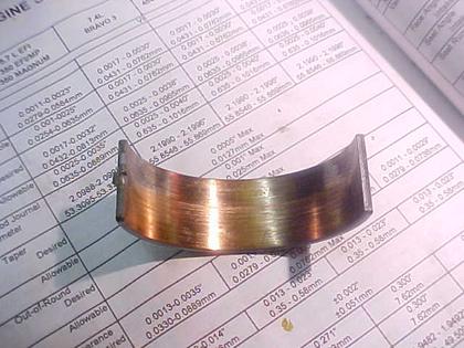

Here is a picture of a main bearing that was in an engine that the oil temp got to 280F. Unfortunately it was dino oil (straight 40) and couldn't take the heat. It broke down, lost it's cushioning ability and caused crank to bearing contact. This engine still ran strong and had 60psi warm at 3500rpm. Idling it was around 10psi. Before the hard run it stayed about 40psi warm idling. Cutting open the filter revealed the flakes of death but also saved me a lot of money because I didn't spin a bearing.

MMMMMMMMM....... Flakes of death! lol So many times people get "hung up" on oil pressure. I'm beginning to think some guys measure the length of their **** by how much oil pressure their engine makes! Boat guys talk about 60 psi and 80 psi... I work on old Aston Martin engines... AND THOSE GUYS DO MEASURE THE LENGTH OF THEIR ****'S BY THEIR OIL PRESSURE! A freshly rebuilt DB5 or DB6 engine will make 125 psi .... even when hot! These guys are crazy. All this extra pressure is an attempt to stave off bearing and cam failure because of poor design from the factory. I like to measure the oil pressure on a tall block at the hole at the very front of the block.... by the right head. It is the very furthest from the pump.... and thusly the weakest point... I know that if I have pressure there.... I have pressure everywhere. I ran 10-40 dino oil and after a high speed run,,,when the engines came down to idle.... the most oil pressure I would see was about 25 lbs. I didn't worry about it because I knew the main and rod bearings were getting oiled.
