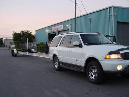

Any trailer manufacturer or parts supplier can get you the bunk bounts for the vertical main bunks. You can use 2ea 2x12 PT boards bolted together on ea side to get you by. use the mounts on your existing crossmembers with U-bolts and through bolt the bunks. Be sure to cut the top of bunks to match the dead rise of your hull.
A couple of 2x6 x8' front center bunks will facilitate loading and provide forward hull support.
Example attached for reference

Those LED taillights?
They look better and dont hang below the frame rails. Know were to get them?

Dan, LED,s can be bought at any truck parts dealer. You really get what you pay for. the cheaper ones dont have as many LED,s in them. The good ones will have an unlimited warranty. My trailer has them all around, they hold up well. www.southfloridatrailers.com

MFB you are correct. Some have very few lights in them.
South FL trailers should also have them.
The one's in the photo are made by PETERSON from the 'Pirahna' line. These are a dedicated marine light with a 100,000 hour continous use rating. Peterson also does truck lights. typical truck stop lights vary in quality.
The Peterson Pirahna's are about double in OEM supplier cost than the ones you typically see at boaters world, etc.
You can order them from Peterson direct, through us or just about any trailer manufacturer or pick up at a local parts supplier who carrys Peterson lights (saves the shipping cost).
Be shure to order the mount if you like the 3" oval in the photo. It is a seperate piece but eases mounting and cleans up the look.
