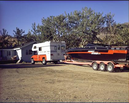

The titan 5 is the way to go, here is my rig, titan 5 hitch with 3 ft. stinger pulling 32 ft. baja
