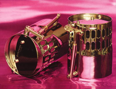

Every add Ive seen states 4-9db reduction. Though his web site states up to 14db. Also according to Drew an 750hp motor only needs the guns to open 1/2 of the way....Again you can adjust the rate of opening by changing recoil springs or position of the spring in the butterfly valve lever. You also can adjust the butterfly amount of opening AT IDLE or AT SPEED.
Call Drew and talk to him he is very easy to contact and really knows his product. GREAT Warranty.
