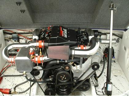

I had bad luck with prochargers design,I had the computer reprogrammed . Without the thermostat it would never get warm enough to get out of cold start mode.Here is what I did, stock thermostat housing stock water pump,moved intercooler over. With the thermostat in with a crossover I checked my block water pressure and it was 45 lbs at 50 mph. Tried a pressure valve and it was a pain,temp was not steady, now it should have a very steady temp,cold start mode shuts off at 105 degrees. Temp stays right on 120!

By the way, it stays at 120 because I put a 120 stat in.

Very nice install. I'm starting to design a supercooler for the 502 MPI engine. Would you like to be a guinea pig?
What boat is that? It looks like the engine hatch on Turbojack's boat.

Eliminator daytona.Are you in the chiller buisness . Let me know.I am always interested.

blown bat, nice work! where did you get the tubing and who bent it up? I also have prochargers on my ride, and have the same problem!

I think I like that name better than mine,blownbat sounds better. I will have to look up where I ordered the tubing from. I started out with one strait piece and 6- 90 degree bends and my friend is a street rod fabricator. We cut and welded them together. I like prochargers charger but who ever designed the install kit did not do very well. I am much happier now.

Yes, you might say I'm in the chiller business. How much clearance do you have between the top of the intake manifold/throttle body and the engine hatch?

4 inches clearance.
