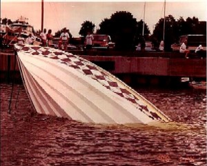

PS
This it what your boat may look like when shutting down to quickly or slamming it in reverse with some good throttle. Some Mechanical problems here.
