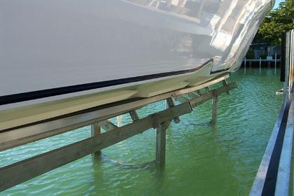

I can get you aluminum bunks that are rubber capped.. The same ones on our boat lifts...
Not the cheap way to go, but certainly nice.
