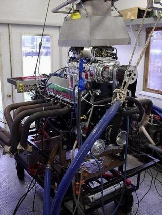

EFI F.A.S.T. ECU
Procharger M3 504 Intercooler
Engine Hours 50
Attached Thumbnails How Much Boost????-engine%2520dyno%25202-04%2520001sm.jpg
