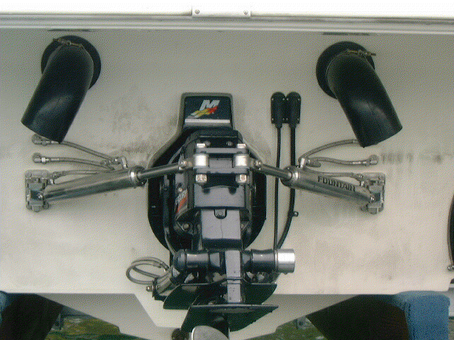

You are going to see in the pictures that I rotated my elbows towards the outside a little, not because of interference, but to ensure that I didn't blow hot exhaust onto my rams during WOT.
Lots of heat, even though it is wet.

Well, the weather was too crappy to do the dB reading, but here is a picture to show how I angled the Troutly Rubber Mufflers outward to keep the heat off the steering rams and hoses. I will try and get sound level readings after I get back in town later in week, and will report.
Sorry for the appearance with all the black on the transom - just rebuilt engine and rings have not seated yet - went thru a qt of oil first couple times out.

Well we had our County Sheriff noise test session last weekend -- the SPBA club that is -
The Troutly snufflers recorded an 88.3 dB actual, and 85.3 corrected (they give the boater the benefit of any possible error - so we get 3 dB deducted)
We had 4 boats fail (barely) out of about 17 or so -- so all in all, it was a good day
No tickets were issued -- our club was actually helping out the local sheriffs department by giving them some data so they could try and shut up the habitual complainers on our lake -- these "do gooders" think it is their lake, and think no one else should use it (ie: jet skis and power boats). They were quite pleased that we would work with them and give them some ammunition. It was like they were on our side !!
Anyhow -- the snufflers worked great -- thanks again
