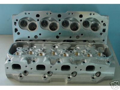

There was a set for sale on e-bay (it might have been somewhere else)a few days ago w/the mercury logo cast in them,i'll do a search and see if they are still kicking around, from the pics we could see if they are ovals or rectangle port,Smitty
Here is the pic off e-bay,i found it under "mercury racing" BUT they don't say in add exactlt what engine these go to but they are rect port,hard anodized,they have mercury racing cast in them AND the bid on them is only 850 w/just over 24 hours left on auction if someones interested!

The heads are custom made for Merc. The headers do have a different bolt pattern than the other BBC.
