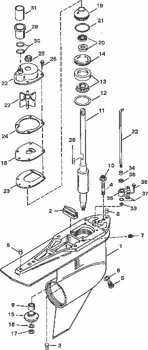

Should you split the drive, make sure that you are careful not to compress the shift shaft where it mates to the geared spline at the rear of the top of the lower half. there are a couple "hidden" (not really but sort of) bolts that sometimes mess with people when they split the drive for the first time.

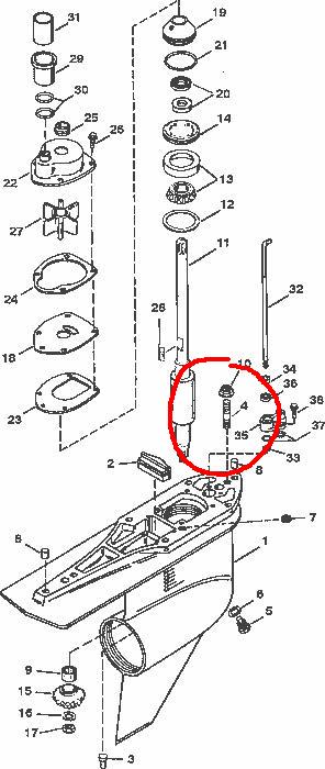

But he's totally right.
There is this bolt....
You will find your hidden bolt when you take of the anode/zinc "tab." It is a honking sized allen. If you don't take of the anode thingy off you will cuss and cuss.
