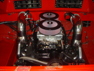

I Rebuilt my SC600 with the advise and help from BOB Teague! They built a set of heads and recommend a cam. I was very please with the results! Just make sure you talk to BOB! I also switched over to CMI, Thanks to CMI for building Custom Tailpipes that fit like a glove! If you have new exhaust built think about having ports added for EGT's And O2 sensor! not much extra cost and will help with tuning in the long run! I was so glad I did this!
Bryan
http://www.offshoreonly.com/forums/a...d=101249&stc=1
Attached Thumbnails 525 sc's-dsc00234.jpe
