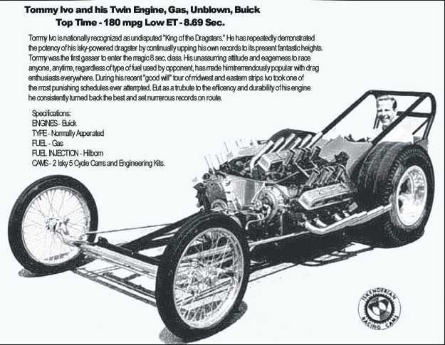

Back in the 60's a drag racre by the name of Tommy Ivo built and raced several multi-engined vehicles. His last was a four engined, all wheel drive car. Two engines were coupled together , front to back, and driving the rear wheels while the other two, facing backward, drove the front. There was one he built where two engines sat side by side then coupled by a single gearbox to drive the rear wheels.
Attached Thumbnails Multi-Engine/Single drive setups-fourengine3.jpeg   Multi-Engine/Single drive setups-fourengine8.jpeg   Multi-Engine/Single drive setups-rearengine3.jpeg

More Ivo
Attached Thumbnails Multi-Engine/Single drive setups-ivo_cover.jpeg   Multi-Engine/Single drive setups-ivo_twin_isky.jpeg
