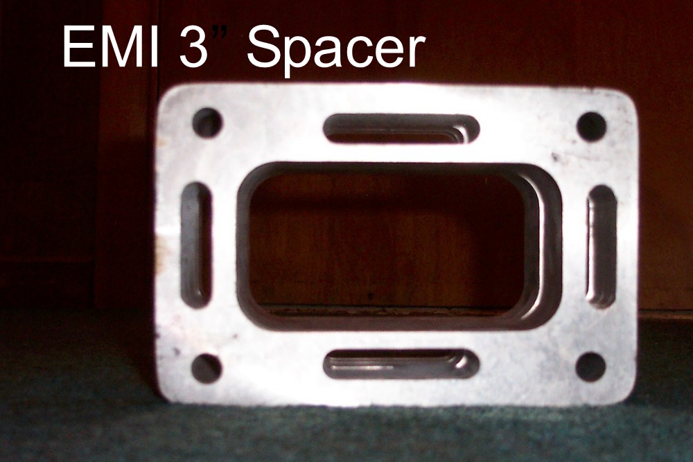

Pic of EMI 3" spacer.
http://www.offshoreonly.com/forums/a...d=113237&stc=1

Looks exactly what Roehr's machined for me, except the corners are rounded. Thanks for posting that picture.

I've got a closed cooling system and 3" risers on my 454 engines. There is a solid stainless steel plate between he gaskets that seperate the spacers from the manifold and the riser. It seems like the spacer then isn't getting any cooling water because the coolant circulates in the manifold and the raw water exits thru the riser--that's totally isolated from either water source.
For whatever the reason the spacer never seems unreasonbly warmer than the manifold or the riser...
Check out the plumbing and parts on BAM's website to verify the solid gasket plate.
