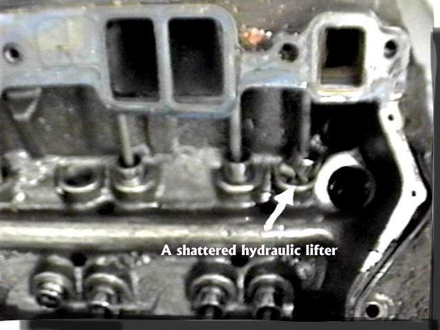

Attached Thumbnails Solid vs. Hydraulic Roller (Performance)-iskys-finest.jpg   Solid vs. Hydraulic Roller (Performance)-oopshyd.jpg   Solid vs. Hydraulic Roller (Performance)-pushthru.jpg

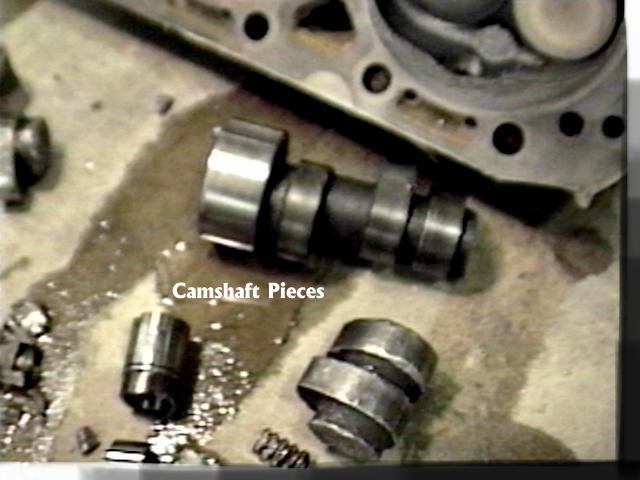

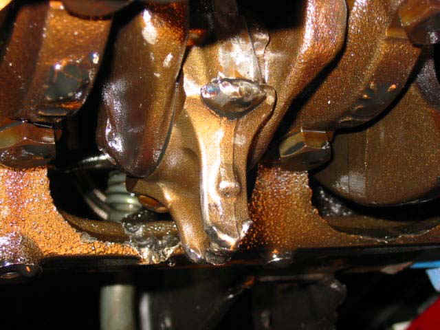

Attached Thumbnails Solid vs. Hydraulic Roller (Performance)-purdy.jpg   Solid vs. Hydraulic Roller (Performance)-rod-said-im-outa-here.jpg   Solid vs. Hydraulic Roller (Performance)-thatll-clean-right-up.jpg

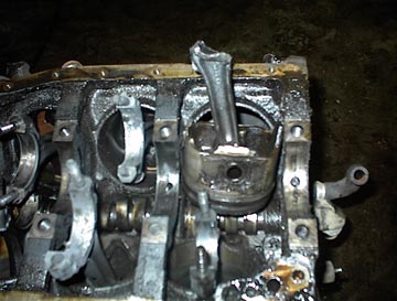

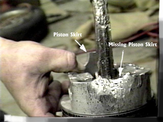

Attached Thumbnails Solid vs. Hydraulic Roller (Performance)-blownengine5.jpg   Solid vs. Hydraulic Roller (Performance)-engine31.jpg   Solid vs. Hydraulic Roller (Performance)-skirt.jpg

That is one beat-up SBC!! Can you put your finger on the series of events that led to that? It almost looks like maybe the lifter siezed and held the valve open which hit the piston!! Ugly!!

I'm not sure it is all the same engine (although it might as well be) I did a search on Yahoo for blown engine pictures. Some of them were too scary to post
