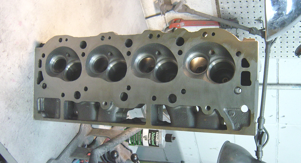

The heads are new dart iron eagles.
Jeff still needs to clean up the ports to get them to flow better.

These are the 308s, and compression should be around 9.3.
Had to replace my oringinal large rectangular ports since one was shot, so Jeff suggested these. And I know the originals are too big for marine use.
