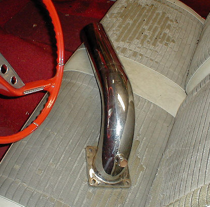

What cam would you recommend for 454 (330hp) Gen V with std bottom end, L-29 Vortec heads, Edelbrock Performer intake/ Holley 300-42, Edelbrock 750cfm 1410 Marine, K&N 9" air filter and complete MSD marine ignition? The exhaust manifolds are stock with this kind of stainless elbows. I have not decided if i'm going to use dry or wet exhaust but probably dry!

That would be a good cam if you use the long risers. Dry exhaust would not be necessary.

Cranes 132561 was the High end flat tappet that mecruiser
used on the Gen IV, V 400, 420, 525sc..... Shouldn't have
any reversion with those risers.
