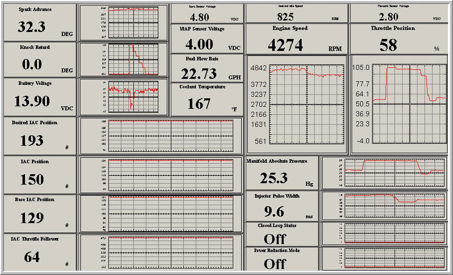

How difficult would it be to get data that MEFI outputs and used for a Fuel Consumption gauge?
At onte point Teleflex said they were going to market an aftermarket Smartcraft system fro older engines but it never got off the lab bench.
I know the data stream includes GPH and that Smartcraft will display data but only on MEFI-4 controllers. No one can sem to say for sure if Smartcraft would read MEFI 1 data so I'd like to just get this one piece of data nad display it on a digital or analog guage.
Flowscan on my engine becomes too complicated because my EFI system returns unused fuel to tank.
Possibilities?
Possibilities?
Difficulty is a matter of perspective
At one point Teleflex said they were going to market an aftermarket Smartcraft system fro older engines but it never got off the lab bench.
Mefi4b can use the canbus which is what the smartcraft data is transferred on. Not sure if the earlier mefi4's have canbus too, never looked.
Possibilities?
Of course, anything is possible and this would not be extremely difficult as it would just be a matter of monitoring and identifying the GPH byte in the datastream using a small micro that could in turn change it to a digital or analog signal that would be used by the Digital or Analog guage. There would have to be quite a bit of interest for me to move this up on my priority list which is quite extensive at this point in time. However, I would suggest a digital display that would also show knock retard as well

B&G Instruments makes a display that will show data, including GPH, from the serial data stream of a MEFI ECM. They call it the "Network Engine Instrument". I think it runs about $400.00.

A few weeks /months ago I remember seeing a advertsing of software for reading/ analysing the mercruiser ECU. It wasn't that expensive and (as long as you can believe publicity) very easy to use on a portable!
Can anyone remember that adress? thx reply
I don't know the current production status, but I have seen the B&G Engine for sale on a few websites. Google "B&G ESYS".
Evaluex,
Was it the "Diacom" marine EFI software from Rinda Technologies that you saw? I am not aware of any other software products for monitoring / diagnosing MEFI systems.
Dave
Evaluex,
Dave
