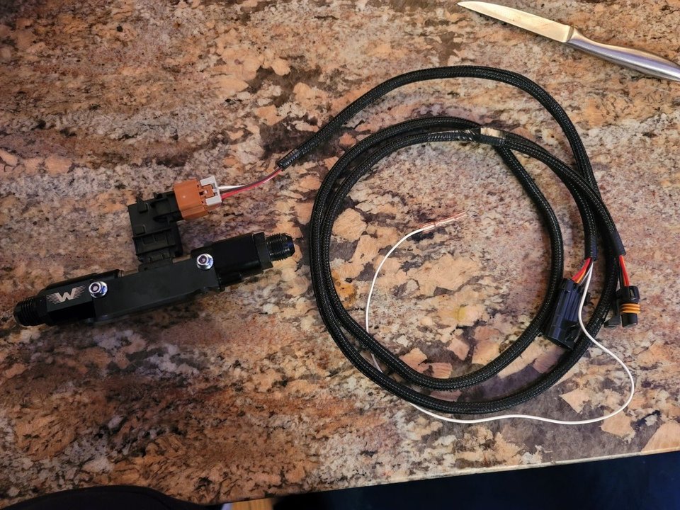

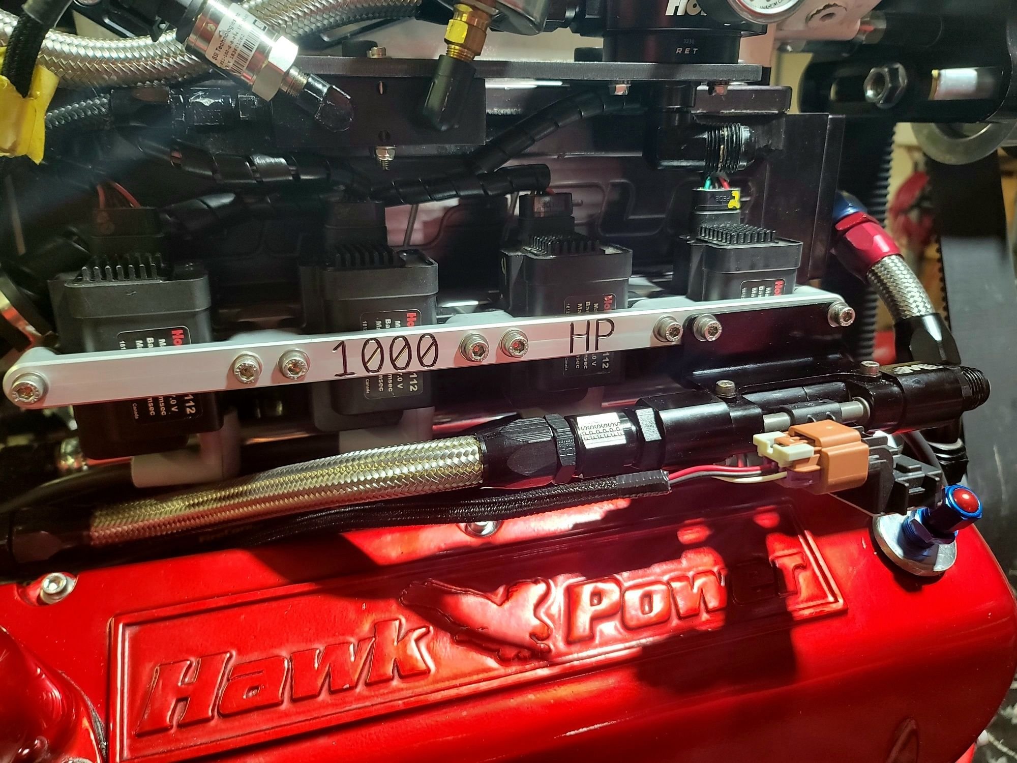

Use a compensation table, a flex fuel sensor and mix in E85.
Drops intake temp 15*
