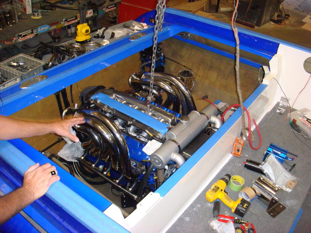

Yes they are great engines - my only complaint was the rigging headache to get them in there. I've thought about the 710's myself but after talking to other's I wonder if they would eat drives on my 38 Fever. The 625's have been about as turnkey as it gets.
It is an extremely tight fit at best for any boat built built for a BBC and is literally undoable in some boats.
Note the mold level clearance built into the engine compartment to clear the water return from the "mixer".
You are probably dead on about another 75hp a side eating drives- the 710 spin another 300 rpm as well although I rarely get to run up there on the Ocean my little 28's too small.
Uncle DaveAttachment 425658
Tight but looks sweet

I definitely had it easier not doing a retrofit.
