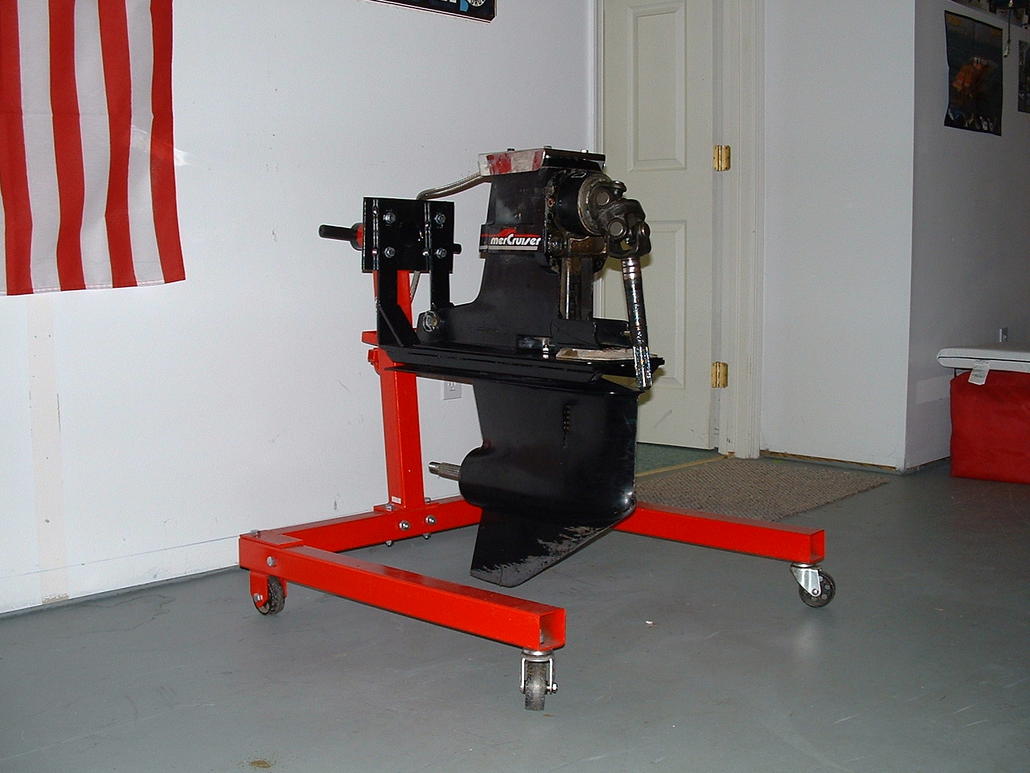

I built one out of an engine stand I had lying around. Got some L-brackets welded and bolted them on.
Nice Hustler poster

alright you crybabies. Dont laugh about the paint, it was just to keep it from rusting and I didnt have enough to paint the whole thing.

[QUOTE=Philm;3204935]alright you crybabies. Dont laugh about the paint, it was just to keep it from rusting and I didnt have enough to paint the whole thing.
Thats a good idea using the jack

Originally Posted by Strip Poker 388
Nice Hustler poster
You have GOOD eyesight! I can barely make it out in the pic.
The jack is cool! I just adjust the tongue jack to get the right height. That might not work on s bigger boat.
