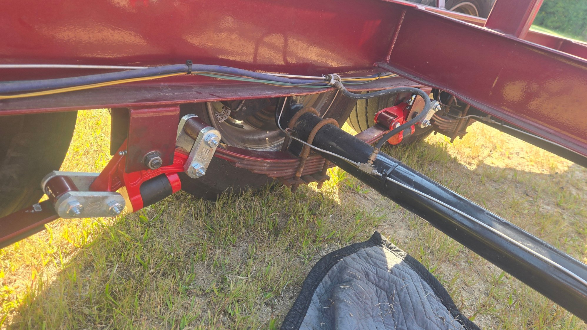

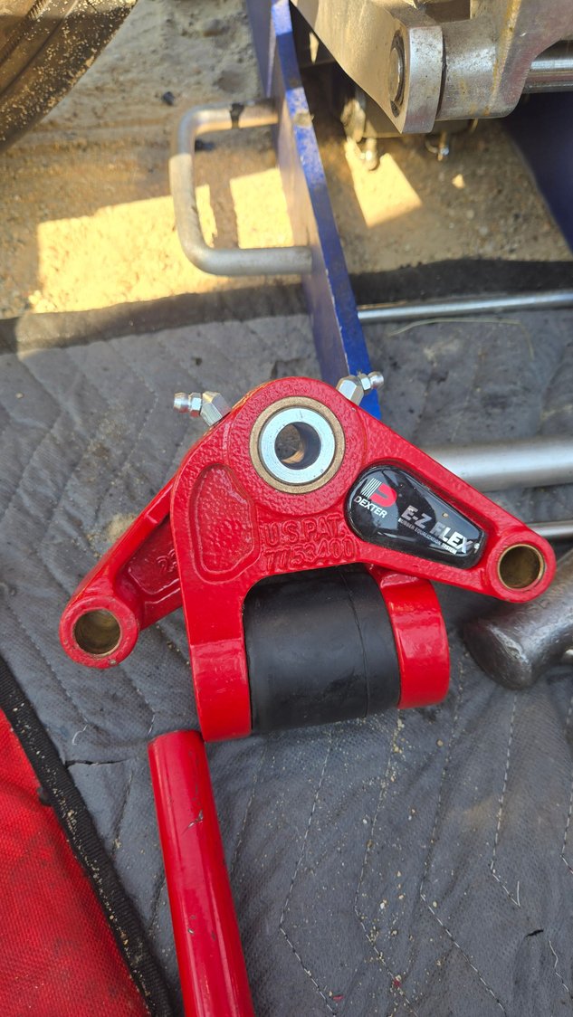

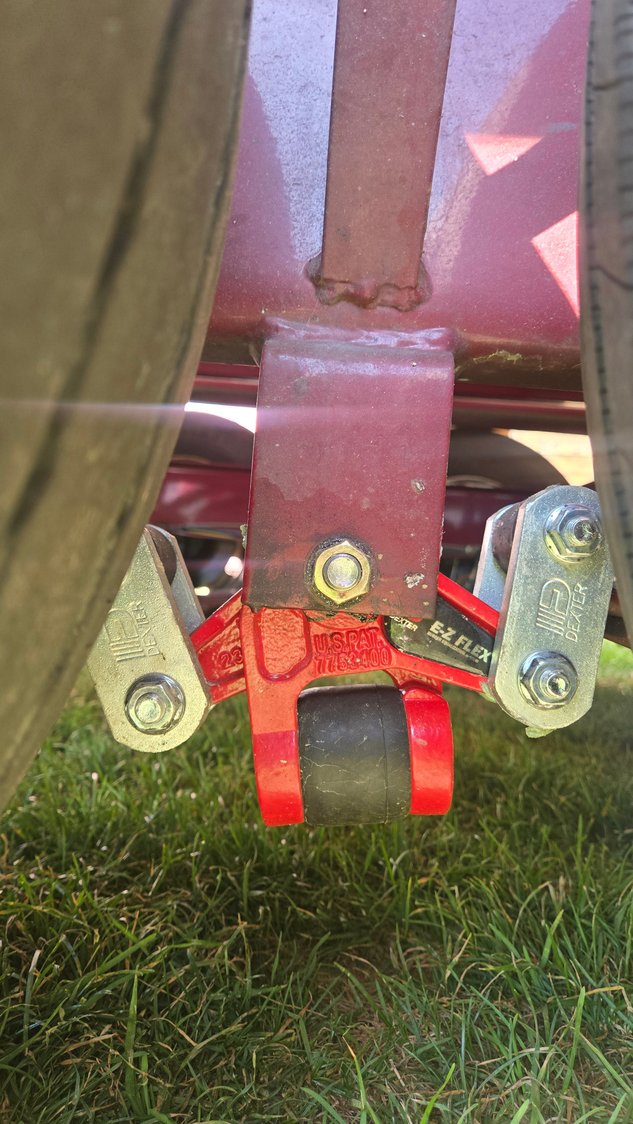

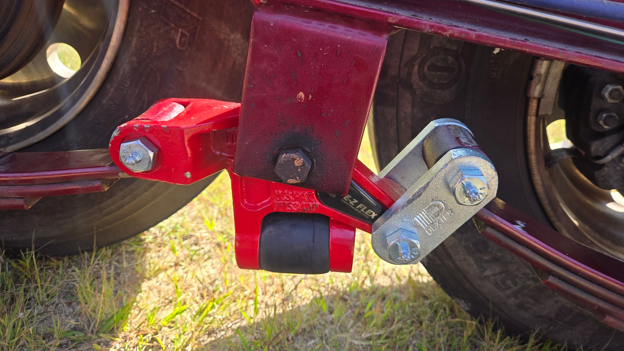

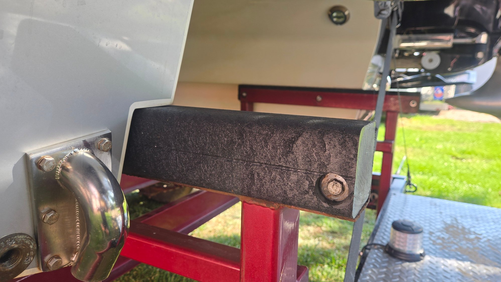

Did some trailer upgrades.
New plastic bunks, no more rotted wood or torn carpet
The custioned links give it a better, quieter ride. Very greasable.

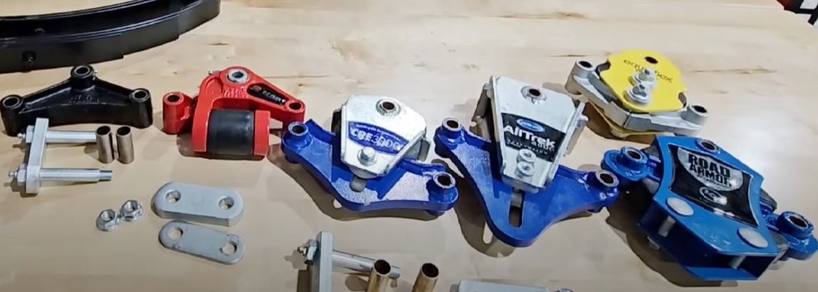

What made you choose that brand? I've been looking at them for my 44' triple axle toy hauler. There are a few out there. Were they a PITFA to install?

I`ve always liked Dexter products... also it`s red so a no brainer
The first 2 took a bit.
Once I figured out that dissasembly is best with no jacks and assembly only needs a jack under the cross bar to bring the second spring closer it was easy after that.
Boat was off trailer of course.
