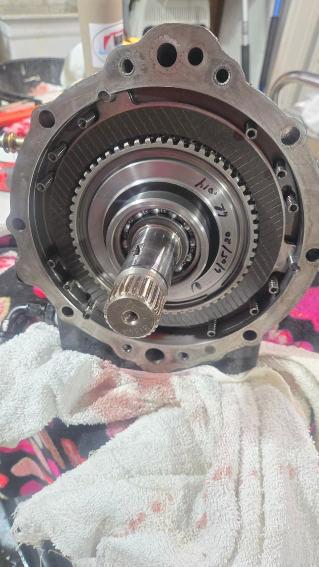

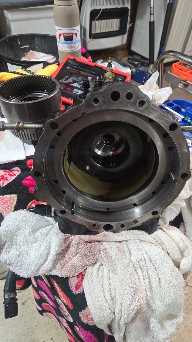

ICDEDPPL 09-03-2025 08:35 AM
Rebulit kit and all new clutches and steels $500
plus you tube video, I`ll have this back together by the end of the week.
I`d like to kiss whomever at Nortech designed the rear opening to get a trans out without having to pull the motor. :drink::drink::ernaehrung004::ernaehrung004::kiss: :kiss:

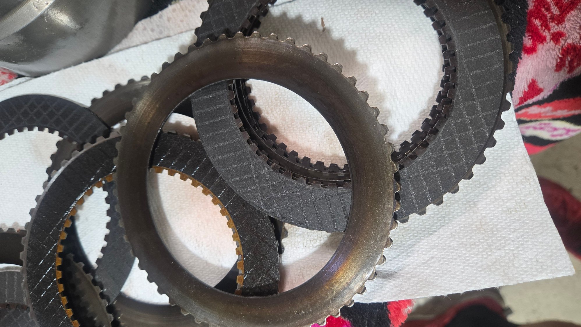

ICDEDPPL 09-03-2025 03:57 PM
Originally Posted by CNC (Post 4933997)
I guess I asked, because mine went out, First time getting on plane with refreshed motors. Which YouTube video did you use?
One thing about these 3600 Supercats is my shift cable bracket is attached to the driveshaft cover.
Double R had a case where a customer went thru 4 transmissions in a short time.
Couldn`t figure it out so they set up a Go pro in the bilge. In a turn the cover would flex and just pull it out of gear , once that happens the trans ****s the bed instantly.
I had 3 out of 4 screws in the cover and one was stripped.. the trans burned out in a turn.
So now I will always make sure that cover is tight with back up nuts.
The cluches don`t look too bad, for whatever reason all the fluid went out the front seal into bellhousing but seal looked fine .. don`t make much sense.
These were rebuilt by Bam to 1300 in 2020 with very little time on them.
This is the reassembly video but he has dissasembly also.
