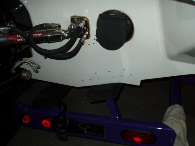

I removed the Bennett tabs. I had a local fiberglass shop fill all 38 transom holes and regelcoat the transom. Turned out great. After several phone calls
to Eddie Marine, I finally got all the parts to begin installation of the new billet tabs. Like everything we do on these boats, it's always more work than anticipated. Because of the already tight transom, I went with a single ram (at least it's metal) system. I also moved the tabs out 1' towards the chine as you can see in the pics below. I ran into a problem clearing the swim platform supports at the side of the transom, and had to machine the transom hinge plates to clear them.
Since I went through the powdercoating when I reworked them, they are off to a local powdercoat shop to have them recoated black. I'll post more pics when when I'm done.

Guys:
The powdercoating looks great, and the transom installation is done. The pump is mounted. Just finished/adapted the Bennett wiring harness to the Trimmaster wiring. Found out the color codes are completely different.
I'll order my new trim indicaters from Fred/Trick Marine. I'm leaning towards a larger version of the one slot Gaffrig/Livorsi on the dash now, a "thin" 3 slot version. One of my friends says go with the Stainless Marine "pecker" style.

Except for the indicators, which I'm ordering from Fred this afternoon, I'm done.
I'm really pleased with how this turned out. Compare the old Bennett tabs, and their positioning on the transom, with the billet Eddie's. This doesn't guarantee that the boat will be any faster, or handle better, but it couldn't hurt, and I think it looks a lot better.
