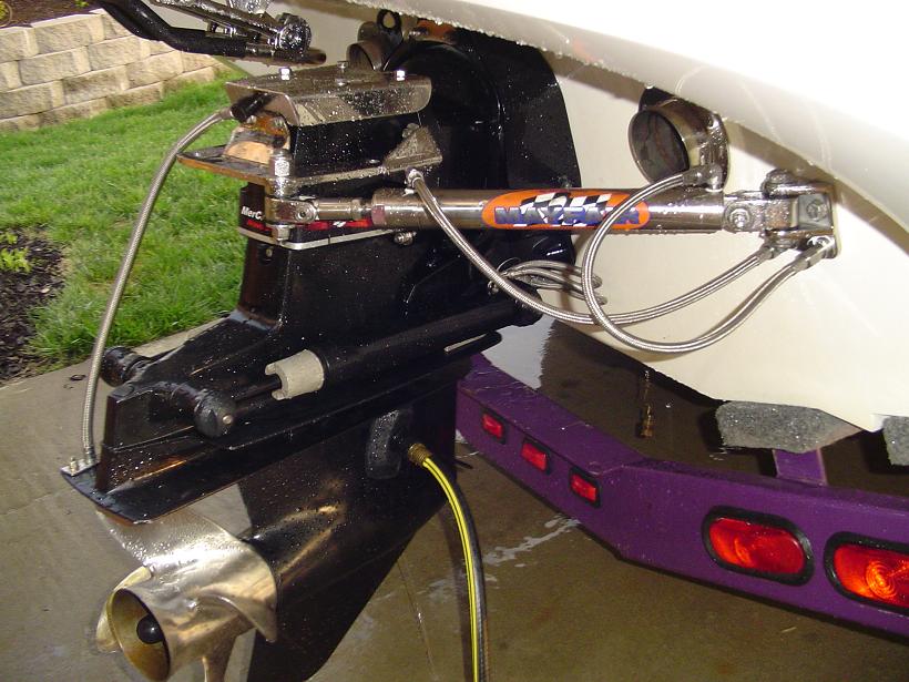

2 Attachment(s)
I am bringing this back up to the top for Desertrage. Here are some pics of the steering install. I did have to put in some trim ram stops so the wingplate would not hit the swim platform.
Attachment 366040
Attachment 366041

DesertRage 10-29-2008 11:17 PM
1 Attachment(s)
Tom,
Thanks for bringing this back up, I appreciate it! It looks like the Mayfair kit cleared your exhaust no problem.
Are your tips completely submerged while floating? I forgot to check mine before the season ended... :o My previous boat had quite a crackle at idle, since that motor is headed for this hull I am a little concerned about the ability to run mufflers.
Are the trim ram spacers you installed internal to the rams?
Incase anyone is interested, here's a virgin transom with the 02 era exhaust location.
Jon

Plane Silly 10-30-2008 07:27 AM
I was told by numerous people that the heat from the exhaust was not a problem for the steering cylinder. I did loose a little turning radius after the install.
My exhaust is below the water line while floating. Its funny how people say my boat is quiet around the dock......then I take off :drink:
The trim ram stops do go on the inside of the cylinder. Its very easy though, you don't even have to unhook them. Just unscrew the glan nut on the end and the "U" shaped stop slides over the ram and into the cyl. It took two on each side for mine, they run about $8 a pair.
