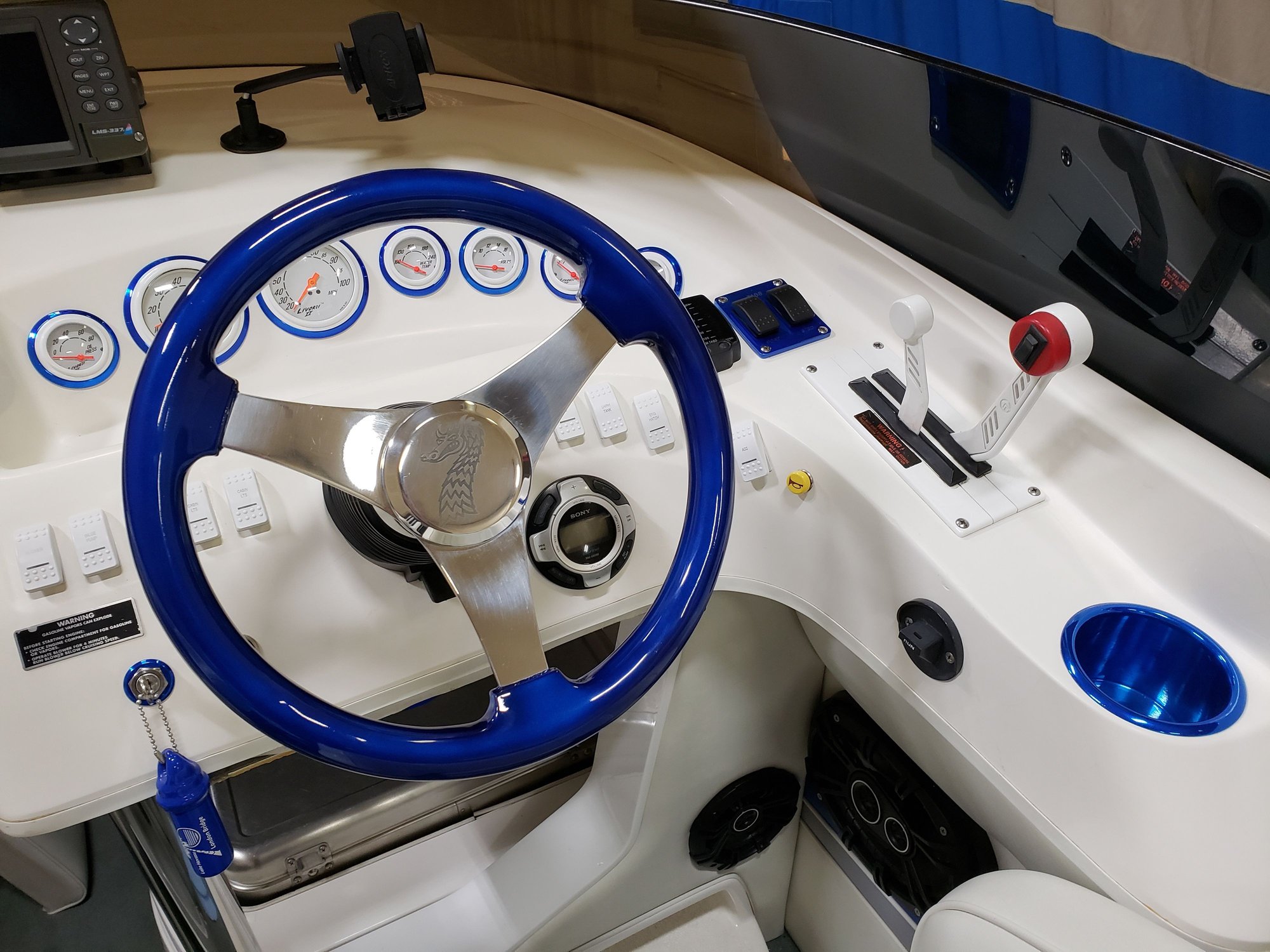

Cool Help with dash switches
Hey Beautiful Nordic Heat!!!! I just picked up one - it's previous owner didnt take the best of care It's missing the White Carling switch covers - switches are still present, but not labeled - I was hoping you would give me description of what each switch does (on your dash) so I can purchase the appropriate Carling switch cover?
I'm assuming the layout is basically the same - Thanks in advance!

From the left:
Blower, Bilge Pump, Nav Anch LTS, Cabin LTS, Cabin LTS --------Steering Wheel--------- ACC, Court LTS, LHRH Tank, Eng Hatch, drive tilt (see picture), ACC
The replacement covers I've seen in white have the light strip on the top, and you can see mine are along the bottom of the switch. I'm not sure if the Carling switches are universal where they are actually supplying light to both top and bottom behind the cover?

Hey THX for the quick response and info!! I was able to figure everything out (I got the boat last night and really didn't get a chance to explore LOL) Thx again!!!!!
