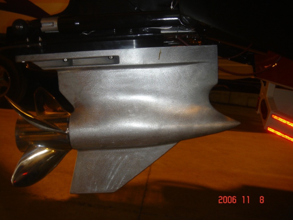

What did ya do about the Imco lower mateing up to the B Max?

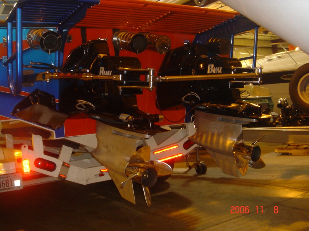

Gary Miesenberg did them I'll find out what they had to do and take some pictures. I had the crescent shaped B-Max and switched to the IMCOs .
BBB725 is offline

Default Re: 1998 37 complete remake
The water passage between the imco and the Bmax upper don't mate up very well,Dean said something about machining it but still doesn't line up well.I guess you had to use the Bmax vert in the Imco lower?
Did ya notice any difference between the Imco over the crescent lowers?? I am waiting on my lower now. Iam running stock bravo style lower now.
Rob

I haven't run the IMCOs vs the B-Max cresent, but I was at a 30% slip factor with the B-Max so I switch to the IMCOs and added 1" spacers to get deeper in the water. I ran stock XZs vs IMCOs and would run like 99mph @ 5000 rpms and 96mph @ 5400 rpms I put the IMCOs on and ran 110 mph with the same props. I know they had to use B-Max vertical shafts and that was sent out someone. Will get all the details and let you know. Also Mark was a big help to my engine builder with the mapping He couldn't get up here but I know they both spent alot of time on the phone. Thanks again

Some pics of the IMCOs on the B-Maxs
Attached Thumbnails 1998 37 complete remake-dsc01317.jpg   1998 37 complete remake-dsc01319.jpg
