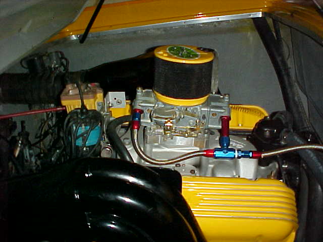

I got the motor back in my 24 in time to run it Quite a bit saturday. it ran and sounded great! The mid-range was an
Extremely noticable increase, I ran it with a 25 tempest plus
prop , and it consistantly ran 68 on GPS but I couldn't turn it but 4350-4400 rpm. The boat likes to run alot of trim when running it hard, it rooster tails pretty good, I would imagine
the X is a little low. I am thinking about trying a 23 mirage.
Would any of you experianced Pantera experts like to give a recomendation. Mirage , mirage plus , bravo , Hydro-motive
ect. The motor should be making 450-475 hp. I posted a pic.
because I know we all love pictures for some reason. Thanks Guys!!!!!!
