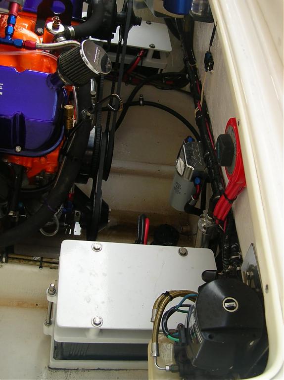

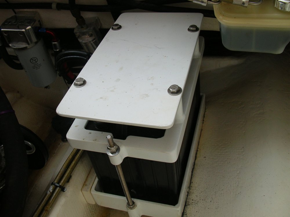

Here's a couple of pics of how mine was setup.
