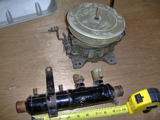

The oil cooler I have is apparently stock. Funny, when we decided to break the motor down, ITTLFLI said let's pull the oil cooler and see what we've got. I had to ask him where it was, and what it looked like. Again, I'll be humble in my ignorance. But, I'm learning.
Here's a pic of what I currently have. Stock Merc F/A, and the oil cooler is 2x9".
What are the suggestions?

Tim was this cooler mounted down low by the motor mount? We usually mount the larger coolers on the back over the bell housing. You really should run a themostatic oil filter head if you plan to run in the Great Lakes. Look at Hardin, they have a version that can mount on the front of the port head with the filter vertical pointing down.

Yep. mounted under the Port side motor mount.
Not sure what I need and don't need. Lake Erie was my backyard as a kid, so that's all I'm used to.

You will need to run a #10 braided line like Goodridge or Aeroquip on the oil lines. Your cooler has provision for oil and power steering both. I think Sue is coming to Hebron the week between Christmas and New Year. If you are going to be around I might come with her and bring some of my catalogs/wish books. If you have your engine there I could go over some of what you need and how to do it.
