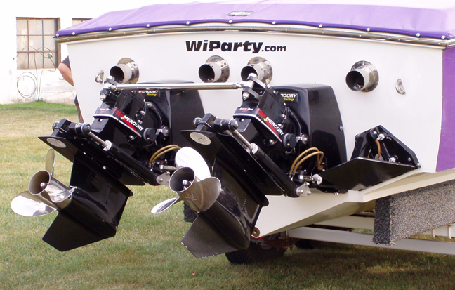

has anyone ever put or seen extension boxes on a twin 28? i can buy boxes cheap but wanted to see if i could get some feed back if they worked well or not worth the work. i saw a few singles that seemed to work well but never saw a twin yet.

Ask Scott(Littledcsrodshop), as he had one.

sh!t thats a sweet set up!!!!

Those are ITS's , they make for a nice clean install on a new boat but most guys that want extension box's arn't happy with just 6" . But they do look bad a$s on there so imagine how sweet a set of 12's would be !

Yes they are ITS's which gives you a 7" setback.. (so joe you were on the money, just came up an inch short.. haha) The boat handled great at All speeds, but at the same time it only had 270-280hp per side, so it's not like we were talking about a rocket ship or anything.. However I honestly don't think in my best experiance fooling with this kind of stuff that it would have started doing anything any differant or crazy as compaired to a boat that had regular transom assy's if it were to have suddenly picked up 10-15 mph... I ran the boat one summer, and pretty much just enjoyed it with my family, and didn't bother playing with props, ect..ect.. because I knew what I had in mind before I towed the boat home.. It was spinning a pair of 3 blade 23 Mirage plus's (spinning them out) and would run right at 63-64 mph on GPS with believe it or not around 6-7% slip... which was very impressive to me.. I could have possibly picked up a mph or two by spinning them in, but at the same time could have possibly lost a mph or two, and wasn't a concern...
The boat was really in better shape that I thought it was going to be in when I went & picked it up.. The engines & drives were in Great shape.., and the hull was solid as a rock.. It had been painted on, and for lack of better words wasn't the kind of job that would have left my hands, but I have seen Much worse... Had I not already had another boat at the time I would have kept it & redone it all...
As for how a set of 12" setbacks would do ?? I'm not real sure, and I have never seen a pair on a twin either.. I remember a few singles with setback, but no twins off the top of my head.. I have no idea what kind of prop slip you are dealing with now, what props your running, power, ect..ect.. (seems like you have 415 502's though ?) Anyways I'm completly guessing at saying a 73-76 mph boat, but ?? As I said I can't speak for a pair of 12" boxes, but I wouldn't hesitate for a min to run a pair of ITS's on a boat like that... (which I know ITS's isn't the question here, but the only thing I have first hand experiance with, and possibly the best compairison you have at the time)
