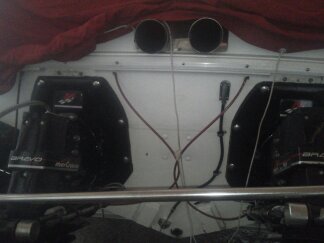

if you dont want to reglass your transom get yourself a adaptor plate to bolt your gimble onto. it worked great on my friends 27 magnum. or call jo and get the height that works well on 24's measure and start cutting.
