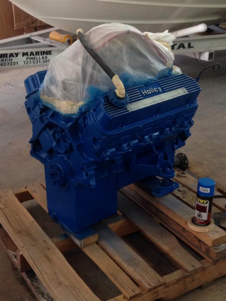

Been at a complete stand still ...between work and moving haven't been able to accomplish anything.. got all the glass and paint work done its just a matter of putting it all back together.. if i ever get the time.. here a few pics i shot a few days ago.
