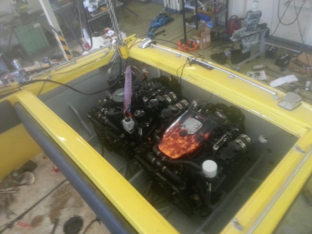

Just took my Pantera 28 from 89 out for the first ride after installing 383 Reman engines and Bravo 1 drives 1.5:1 ratio. I fitted 2 ea Mirage plus 25" as I had them already.

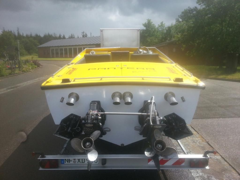

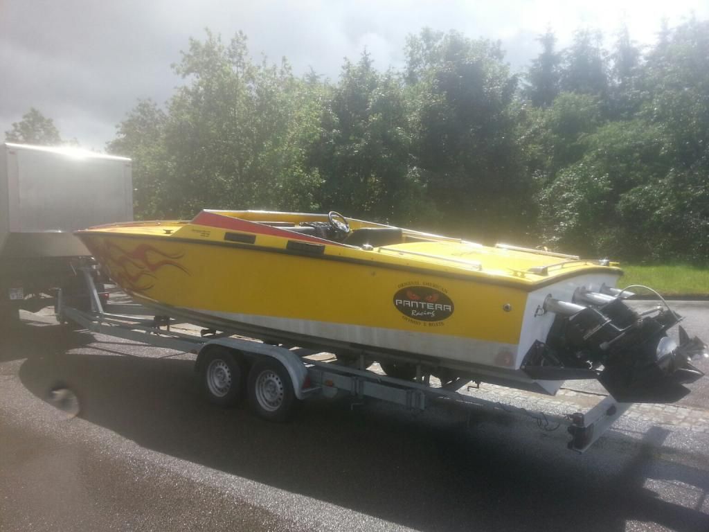

[IMG][/IMG]
[IMG][/IMG]
Knallan77 is offline
Old 07-22-2014 | 02:52 AM
Joined: Sep 2013
Posts: 42
From: aabenraa, Denmark
They don't show much about the X-height but I live quite far from where I store the boat so hope it could help the trained eye!!!

With the higher "X" your gonna want a four blade. I'd try the pair of revolutions then try a bravo 4 blade . The hydromotive Quad 4x would be another good choice as they they have a round ear to give you nice bow lift.

The last thing he needs is bow lift try some bravo 4 blades and spin them out. Also Check the drive toe 1/4 inch toe in is abou right .
