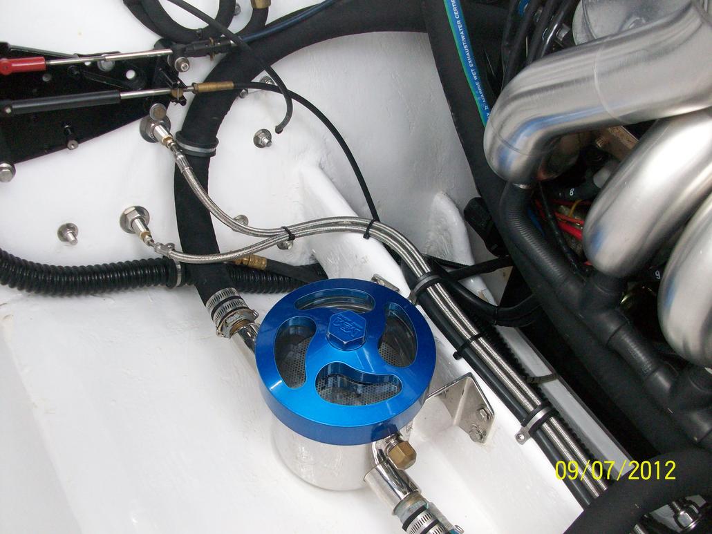

My 24 has Marine Machine raw water strainer. It works great. It even strains out fine sand pebbles that you can catch at crappy launches.
Attached Thumbnails raw water strainer-100_4656.jpg   raw water strainer-100_4657.jpg
