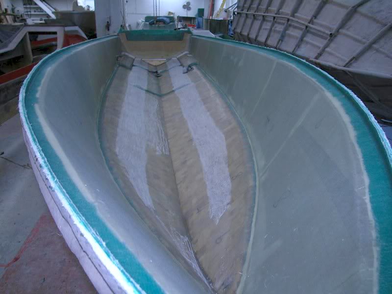

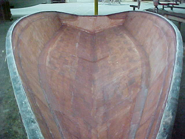

Ive got some pictures off of some older post where it clearly shows balsa coring on the sides going down to the keel line . A lot of builders will core the bottom and just cut the coring back where the plan to use a transducer . trying to upload pic's but if I can't I'll post links . Even the asian 41 has a clear view of the balsa core used .

Seriously do not no why you would make such a statement . Coring has been used for fifty years . It adds strenth and regidity and with the modern day foam coring thats avaiable it does so without adding weight . Some builders offer a race layup that is just aditional coring in the sides . added cost but makes the hull bullet proof . [ATTACH=CONFIG]540639[/ATTACH][ATTACH=CONFIG]540640[/ATTACH][ATTACH=CONFIG]540641[/ATTACH][ATTACH=CONFIG]540642[/ATTACH]
