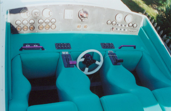

cockpit

Lou,
Very Cool!!!
Best of Luck with the new lady in your life... Just remember to keep the other one happy...
Good luck with the re-rigging...

COOL RIDE DUDE....GOOD LUCK and welcome. im fairly new myself
i probably would have gone after it too, if I didnt pick up a 28 early in the summer. its gonna be alot of fun putting it together. keep us posted.
pics.. WE NEED pics
Bruce

Lou - I actually found that boat for Rob and of course he purchased it and brought it to OC. I was on the boat and I think it's a fabulous deal. I am in the process of putting together a 38 Cigarette with fairly big power and drives, so we'll both be buying a lot of the same stuff. I'm not sure what you are doing for transmissions, but I know where some crash boxes and a brand new Doug Nash trans are reasonably. Also, I have two new driveline pieces which bolt to the back of the trans and connect to the front of the drive shaft if you don't have those.
Good luck.
Barry
