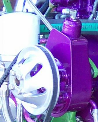

Scott at Extreme in Miami did mine a few years ago. He's located beside the Pantera Factory. You need to have that cap welded on. I've attached a PIC of what it should look like.

CP Performance sells a cnc machined billet cap with o-rings -
It fits on the stock ps pump and doesn't leak .
Call Scott at CP for one - Its a lot easier than welding your standard ps pump.
