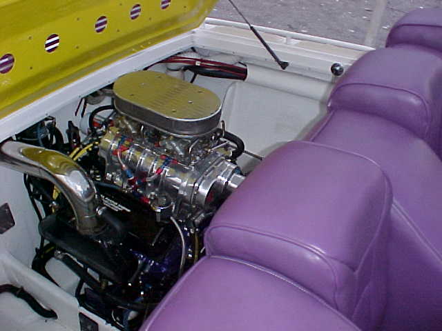

I have a notched trans on my race boat, and if were to step up to a 35 I would do the same. As far as the clearance on a blower motor inside the hatch you would need the non pleasure version to be able to have enough room. Look at my blower motor no added scoop and it clears. BTW, my boat will be for sale soon with the race motor and the poker run motor, the poker run motor is a 598 ci 900 hp blower motor mid to upper 90`s.
