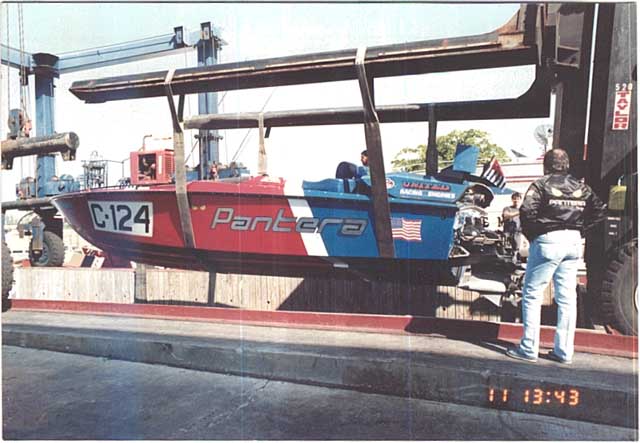

Back in the early 90s we put together drawings for a 28' twin 650 HP staggered small block B-class race boat. It can be done with no problem by moving the rear bulkhead forward and the stringers would need to be set up for a staggered set up.It would not have a rear bench, more like a 3 man bolster set up.
The balance would be perfect.
A 28' powered by a pair of 650 HP Mesa small blocks with a staggered configuration with Bravo 1 XR drives should break 100 MPH with no problem.
Call Laz at Mesa and get a quote on motors and if you need a price on the 28' you know how to get a hold of me.
My Father and I raced this 28' back in the early 90s with twin 650 HP small blocks from United racing. It ran strong.
Regards,
JO - Pantera Boats
