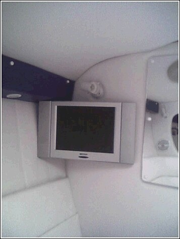

I put a 15' flat screen and dvd in my 34' PQ . Fits real tight up in the corner with a wall mount. Had it done by a professional marine stereo audio installer.They cut a small whole in the vinyl and glassed a wall mount to the back side of the head compartment. It is very solid and look great. Cost about $350 for the install, looks great.

Thanks Performancemary, Which bracket did you use to mount the TV to the wall? Where did you mount the DVD player? Thanks a ton for the info

The mount for the TV was a standard wall mount that you can get at any Best Buy store. I believe the installer built up a fiber glass block on the back side of the head compartment and screwed the bracket to the block then somehow reached up behind the TV and screwed the mount to the back of the TV. All these LCD units have standard mounting holes for use with the after market brackets.
The DVD Player was mounted under the lip of the seat cushion on the starboard bench seat. It fit real nice in that space, didn't stick out beyond the front of the cushion at all. The installer placed a remote sensor up in the corner at the top od the TV so all I had to do was point the DVD remote at the TV and I could control the DVD player.
