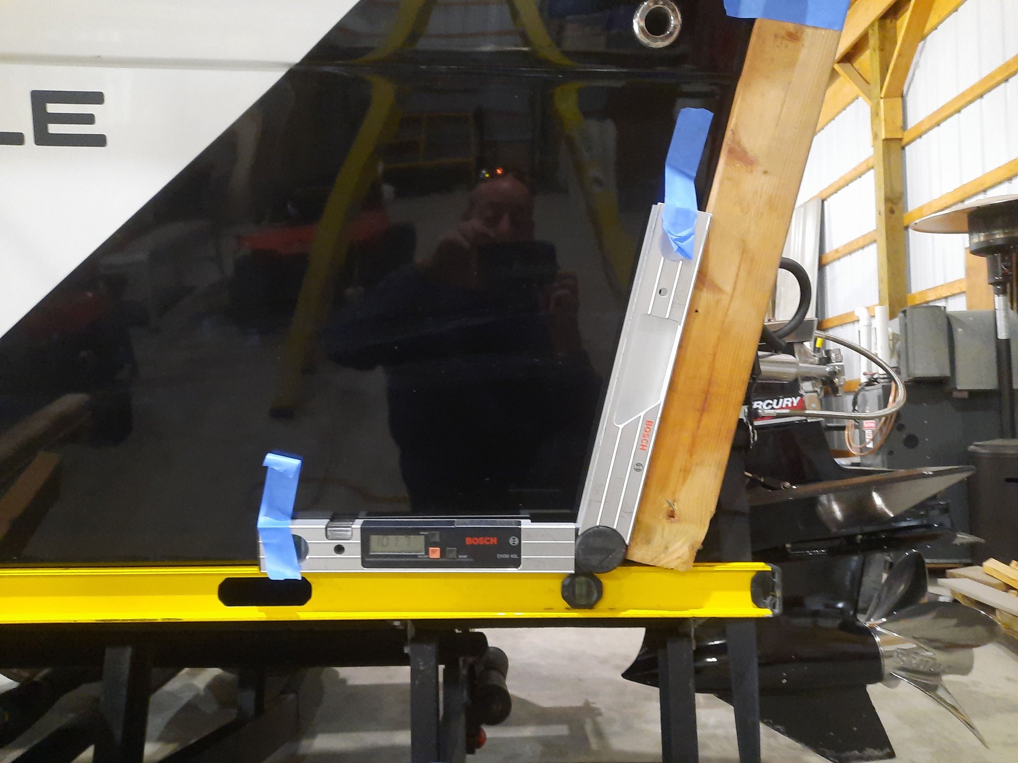

Like the title says, I'm looking for the Transom angle '93 31 Profile v-hull?
Replacing transom that somebody HACKED and want to do it correct.

Hi Gary, my transom is showing 12 degrees. Bottom and transom are not perfect so used a longer straight edge than the angle finder. Let me know if you need anything else. Todd Buchanan 989-289-9240
Stb side
Port side
With longer straight edge
