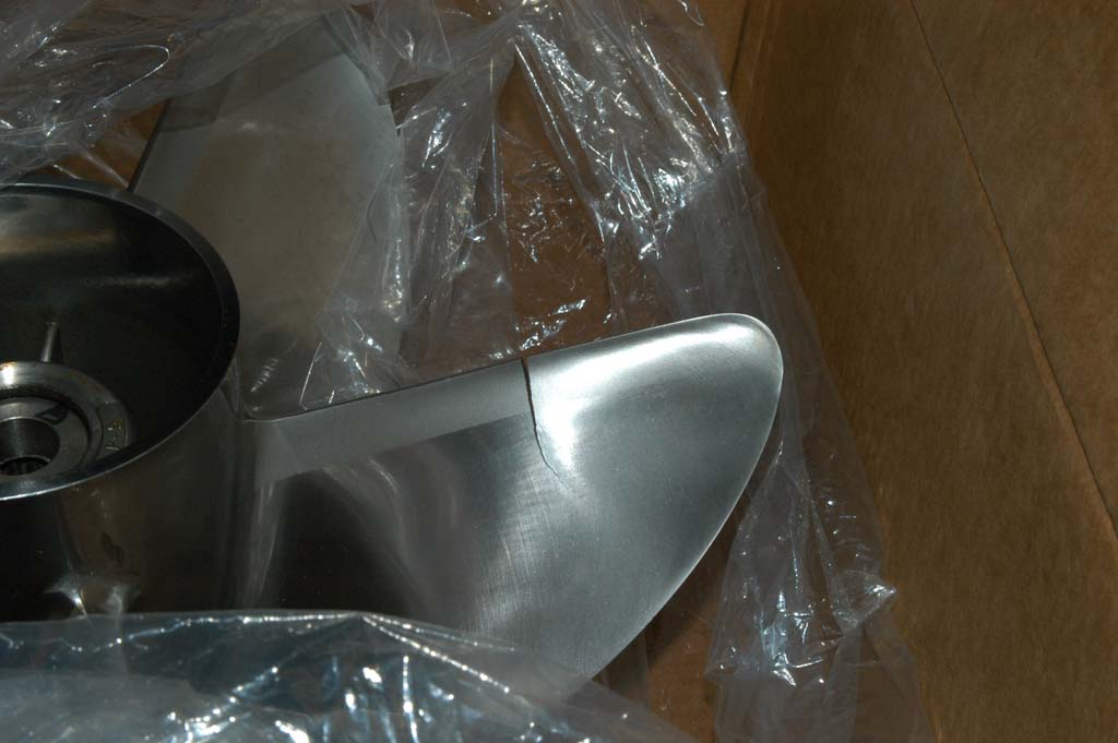

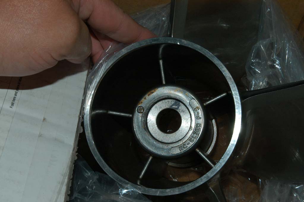

I've managed 2 hours on my new to me boat. When I test drove it in September it ran 106. It ran basicaly that for me until yesterday when it started to misbehave at anything over 85. I brought it back in, an as you can see below the prop ( which hit nothing ) developed this crack. They are Hydromotive P5's. I know the guy who you sold these props too but what I don't have is any of the details on the props. Other than the his telling me you sold them (even have the original box from you), pitch and some basics. You guys tuned them for him and you did a great job. I am going to call you tomarrow and arrange shipping them or one of them back to you. My questions are:
1) Can this puppy be fixed, and should I even want too? Should I trust it? Hate to think what would have happended had the piece cracked all the way. What the heck happened to it? THere are no and I mean no marks on either prop to indicate contact with anything.
2) If it can be fixed, I am still thinking of buying an extra set. Short season up here and missing even a day sucks. Would like to have the insurance. If I want another set, do I need to send the other one down as well?
3) Can you turn these around to me so I have them on Friday? Local Fun run next weekend....
4) What is the warrentee on something like this? Not that I don't want to pay, but once I do and it happens again, then what?
5) What's the difference between the P5 and X5?
Lastly the goal is to have something back on the boat that are identical to what these are (and in the one case, was). I will give you all the details of the boat tomarrow...
Many thanks! Hope you can read this so when I call we are both further down the road toward getting me back in the saddle... Here are the pictures....

Thank you for calling nolimits. I can see from the photo that these propellers are Halls Propellers work, ( the Lab Finishing ). Halls thins blades pretty drastically and cracking is not a rare occurance, unfortunately. If you can provide me with the guys name who sold them to you I can pull his records and convert them to your name and we can keep tracking the propellers , historically. Thank you agian for calling.
Julie
