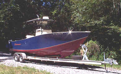

You can take a look at a bunch of pictures on my website about the design and build, there are pictures of the bottom an a lot of other bs. Website is knotreel.com THe hull is Corecell foam cored has huge stringers and is about as strong and stiff as a brick. I have looked at it but never gave any defects any thought as the running surface is perfect as far as I can tell. Chines and all strakes still have sharp edges I didn't think much about the hull as it ran fine, no problem with the Optimaxs that I just removed. All this started with the new engines just installed a month ago. I will take a closer look though as anything is possible I guess.
The engines are set back from the transom 31" to the brackets and props are 47" back from transom.
I have been told the Suzuki likes to run deep but +1" set back 47" that is crazy. Maybe I should get some JB weld and redo the nose cones.
I have said the mercs and hull ran good before but all high speed stuff was done a goodly trim up, these zukes can't be even trimmed to level with the hull which is about 17% on the trim gage and I mostly run them at about 7-9% trim which is considerably under. Maybe the mercs would have got the bow lift pad too wet and lifted the stern if they could not be trimmed either. These are things that are bothering me and thinking maybe this maybe that, I have to just go down the bottom hole and re test then that issue will be done because no matter what I can't see me dropping below +1".

Well thanks for all the sugestions, Bow lift stern, stern lift I really don't know? Thought i did but what I have decided to do is re-borrow the set of 14 1/4" X21P Turbo Ultima4's that I had on the boat with the merc's and briefly borrowed to made an offshore trip when my junk set of "break-in" props would not plane the boat. This was when the motors were in the fourth hole, up two holes from the present. They ran about as good as the props I have tested at the hole two. It will, I hope, be enlightening to see if they run at all speeds in hole two. If they do, then I guess I will have to have a set made from larger diameter props, probably the turbo offshore4's as these are available in their really cool "t-loc" hub that can not spin.
