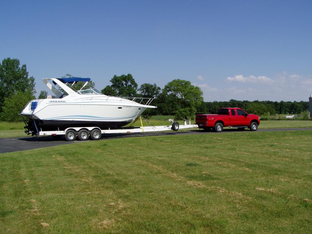

It's 29' with carbed 350 mags and alpha 1 GenII drives. Dry weight is 9000. 140 gal gas. 35 gal tanks for freshwater and holding. So the weight can add up.
Hole shot is acceptable now. Don't want it to loose any though. I believe full throttle is around 3200-3300 when getting on plain,, with WOT at 4600 when going. . Can get real numbers next couple days. Boat does have a good porpoise to it when trimmed out for a smooth ride. All the tanks/ weight is in back. I have to keep the drives or tabs down to stop the bounce, but then it really is running with a wet surface and rougher ride.
Thanks!
