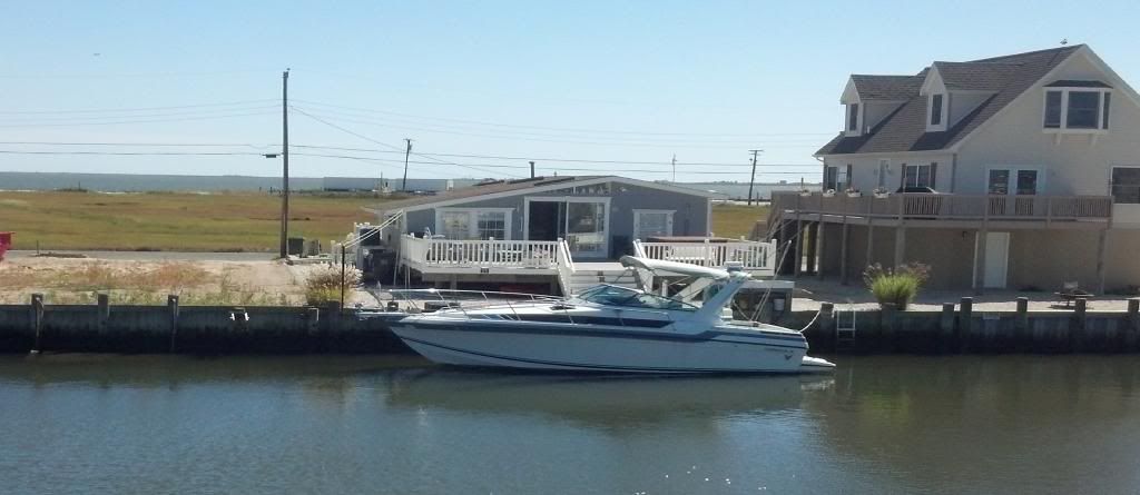

Default prop advice 88 formula 29 pc
I'm running my new used boat at wot @ 42mph at 4500 rpm with b1 drives running inward. Props are 14.'s x 16 four blades Appolos. Boat needs some bow lift and I believe missing about 5 mph from what others told me top speed should be. Has rebuilt 7.4 454s...any input appreciated. Needed to boat a few more weeks@ mike and lyuba
