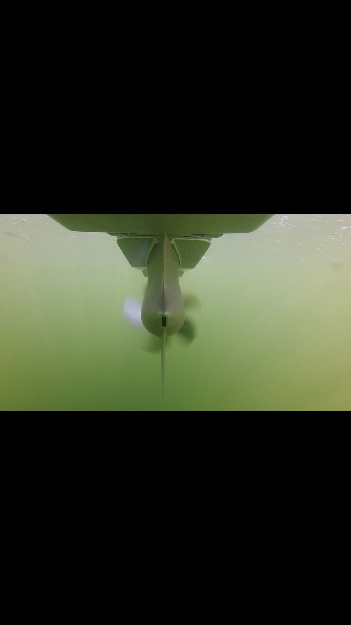

Ran another test.
first video shows the camera wasnt mounted square, have to work on that
second video was at 40 mph, trim nuetral. 27 p mirage plus
the battery died before the wot runs.
its interesting to see what goes on back there and hopefully next week ill get some video at wot, looking for any opinion ( anything look right or wrong)

Cool videos Dan. I did similar on mine. Was going to try mounting the camera on a trim tab pointed at the prop to see if that view was any clearer. Might be worth a shot.

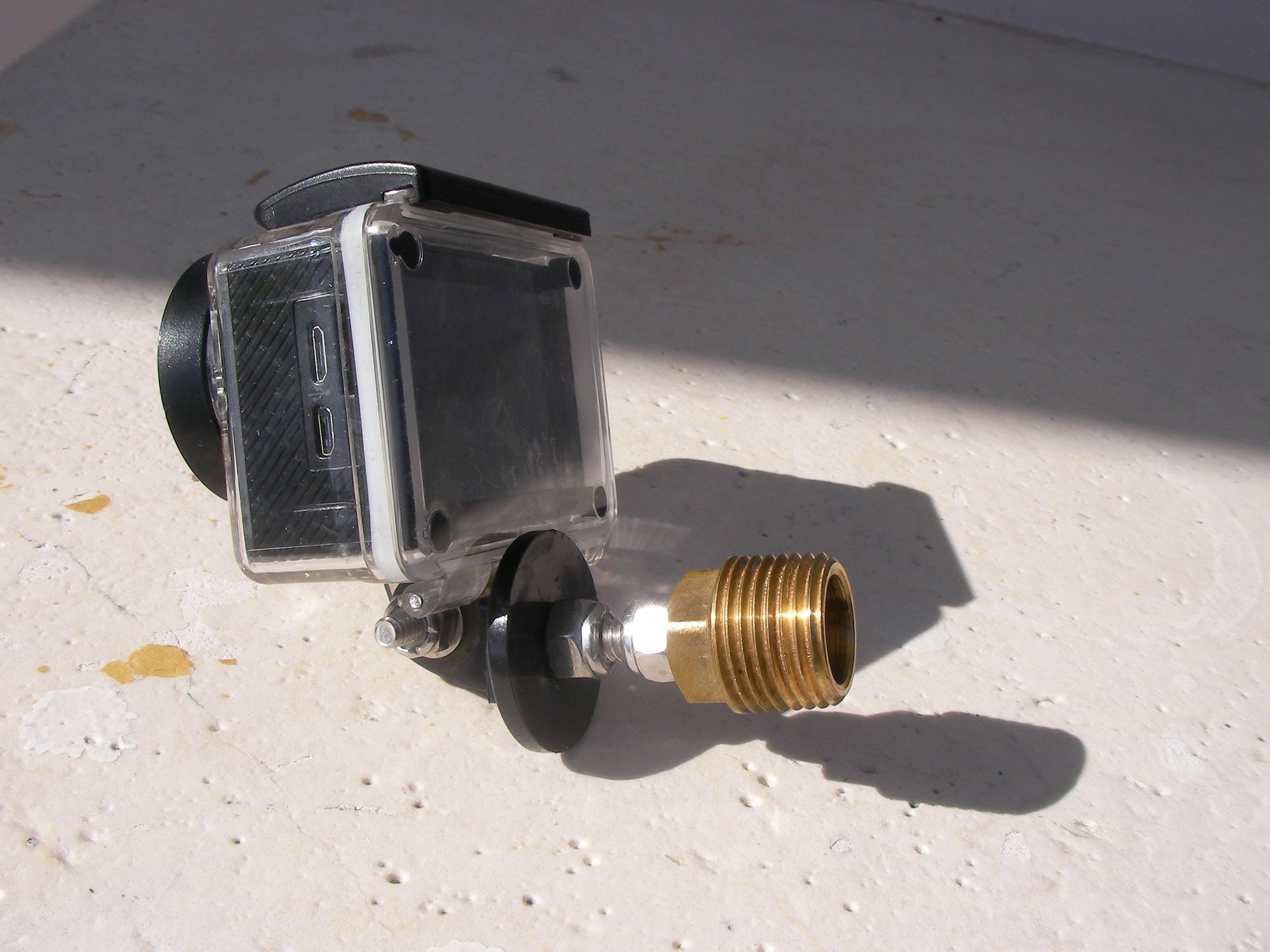

Last video was drain plug cam, it has to be turned on before it goes in the water, the remote doesnt work unless its close to it and then you cant see if its recording or not.
I will get clean wot video of the drive one way or another, i believe its gonna point me or more likely someone who really knows setup in the right direction. (already got advice and that will get tested in the next few weeks)
a cushion clamp frankenstein thing may be in order to get the camera out on the tab or its cylinder

The go pro adhesive mounts are cheap on amazonalamadingdong. I stuck one in the notch on my Baja right above the drain plug and she held on. Matter of fact it’s still on there.
