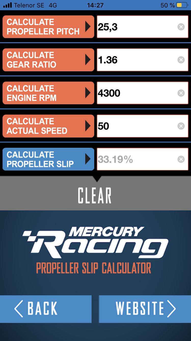

Here is some new numbers with the bravo XR lower. I think the ratio is still 1:1.36.
About 4300 rpm @ 50 mph / 43-44 knots.

This is weird case. Buy or borrow stock bravo 1 prop!!!!! The prop is out of specs or your coupler is done. Stil 33% slip. Take white marker penn and draw line to the coupler, take a ride and check the marked line. Dont know how the bravo coupler fails, but the smaller coupler used with alpha drives can slip before it fails completely.

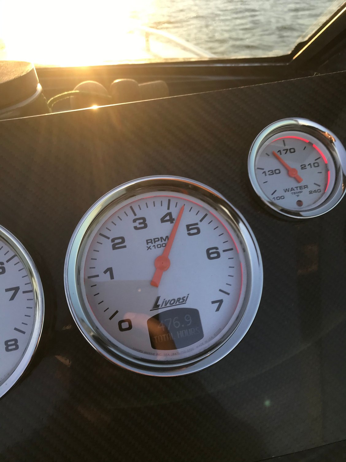

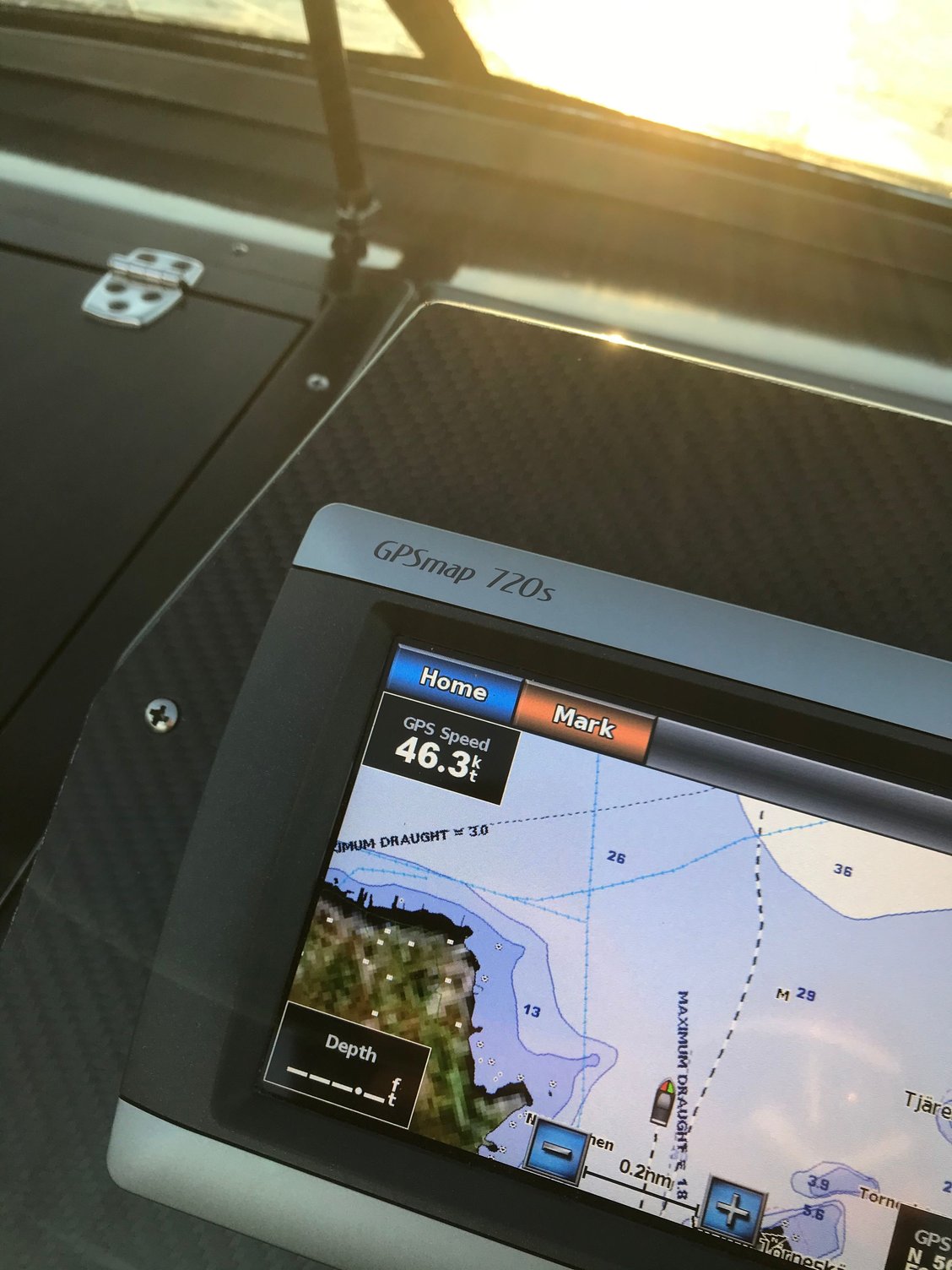

What is the coupler on the drive? Can you show me a picture.
On the way back home I took some photos on the GPS speed and rpm gauge.
Now it shows 46,3 knots/ 53,2 mph @ 4400 rpm.... Yes this is weird lol.... A slip number of 30%
