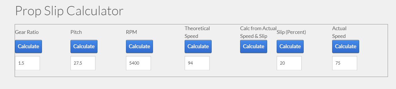

No, because you would be spinning a smaller pitch prop. Deduct .5 of pitch for Bravo props since they are stamped on the heavy side.
https://cimg1.ibsrv.net/gimg/www.off...5a403da564.png
https://cimg3.ibsrv.net/gimg/www.off...357e6641bc.png

But using that calculator, if I can get prop slip down to 12% by keeping it in the water the speed would be 82.5 with the "27.5"p at 5,400. Now I'm getting confused. Maybe I should just try one in the spring and see what happens.

It never hurts to try, but I doubt you will see much, if any, change in top speed in rougher water. With your "realistic trim" you were at 79mph @ 5000rpms = 15% slip. Your slip numbers really shouldn't change using the same model of prop with 2" less pitch at the same trim level unless the lab recipe is causing a little more prop slip.
https://cimg4.ibsrv.net/gimg/www.off...e850b66453.png
https://cimg8.ibsrv.net/gimg/www.off...86ea7e8601.png
